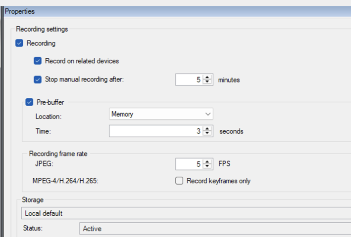

  1. When going for h.264 or mpeg-4 streaming/playback, we could only get 1 fps. Even if we set the FPS higher in api, we’re getting 1 fps only. We have the ‘Record Keyframes only’ setting turned off. How do I solve this fps issue?
  2. Is the mobile server built to support lots of parallel streams, say 10-20 and even further, if needed? Or is there some other way, like streaming directly from the cameras somehow? Just that we need support for both live streams and playback.
Note: Using StableFPS for camera simulation. Keyframes only setting turned off. Frame rate in StableFPS set to 30.
