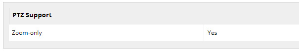

Cameras need to support Absolute PTZ type, please check your camera out on this device page - https://www.milestonesys.com/community/business-partner-tools/supported-devices/xprotect-corporate-and-xprotect-expert/
Also, please check “All tested firmwares” too. If it says Onvif, then you can use the camera with Onvif driver and functionalities (such as PTZ) are tested.
On the other hand, if it says Axis then you should use the camera with Axis driver (in this case, Milestone cannot guarantee functionalities (such as PTZ) with Onvif driver).
The symptom that you saw is interesting but I assume that your AXIS camera might support Zoom-only in PTZ support.
Also assuming that the device page of the camera might not say anything about Onvif but AXIS driver on the list of “All tested firmwares”.
In that case, Absolute might be able to work accidentally with Onvif but Milestone cannot guarantee the behavior and do not support it.
So please check PTZ type and All tested firmwares.

Thank you for the response. We are testing with the Axis P5655 camera (but have also noticed this with other Axis cameras also). The supported page docs are here: https://www.milestonesys.com/support/tools-and-references/supported-devices/supported-device/?deviceId=43746&platform=XPCO&backCloses=true
They seem to indicate that it is fully featured in terms of PTZ. It says PTZ, Zoom-only, and PT-only are supported. However, with the Axis driver utilized, PTZ support seems very limited (AbsoluteMove commands with PTZ options only impact Zoom - neither pan nor tilt change). If we switch the driver to Generic ONVIF, PTZ works much much better (AbsoluteMove commands with PTZ options impact all 3 parameters).

Thank you for sharing the camera information. I also check the device page of P5655-E and seems a bit strange to me too. Let me ask you a few things more. Can you please check your camera’s firmware version and your VMS Device Pack (DP) version? Is the firmware supported by the device pack? I usually recommend to use the newest firmware and DP.
