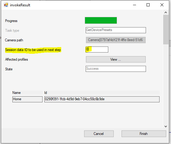

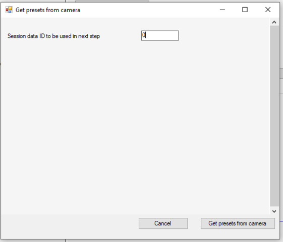

Here is how to make sure it is set to correct value:
First, when you press Get presets from a camera, the following dialog appear:
Make sure to copy ID from in the text field.
After you press Get presets from a camera, invokeResults dialog appear:
Make sure, that the Session data ID to be used in the next step is set to the same ID as in the first dialog. It seems that those two values don’t get aligned automatically.
Once you finish getting presets from the camera in ConfigAPI sample and navigate to the Management Client, you should be able to see the retrieved presets.

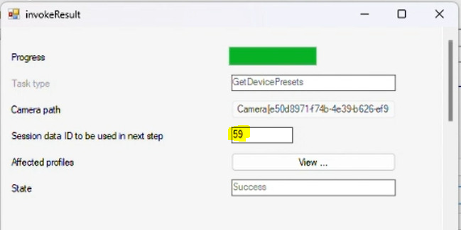

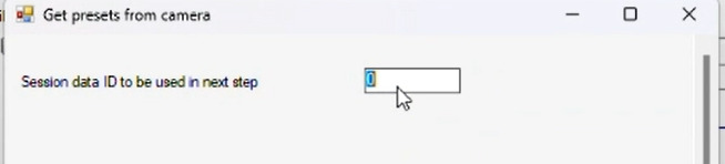

Please find the short video attached
1)MC has 1 device preset
2)Ran Sample ConfigAPI , got two device preset
  1. Refreshed MC but still only one preset
The reason it doesn’t work as expected in your video is that the session ID from the first step doesn’t match the ID in the invokeResult step. InvokeResult step is responsible to getting the retrieved PTZ saved and if the IDs don’t match, the results will not be saved.
First step, the ID is set to 0:
InvokeResult step, ID is set to 59:
That is not correct, the highlighted value should be set to the same ID as in the first step, in this case that would be 0.
Still the same and also getting exception
