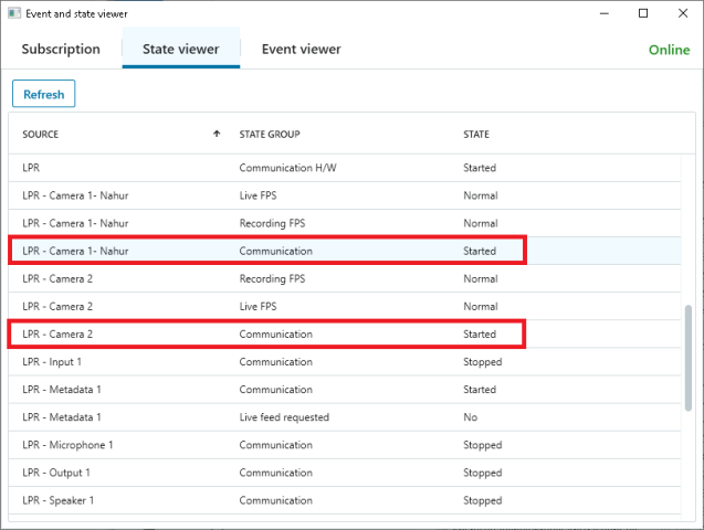

For your use-case, I would second Bo’s opinion, that most probably is better to be used Event and State Websocket API.
It provides you with possibility not only to subscribe for events (communication error for example) but also to get current state of the cameras. Thus, you could connect periodically to the system (for ex on 10 minutes as you mentioned) and get the actual state of the cameras (of interests).
You could see what could be achieved using this API looking at the Events and State Viewer sample.
Unfortunately, it uses MIP SDK for component integration. And as you mentioned, there is (still) not an official .NET 8 version of the MIP SDK.
But the protocol is well documented (I believe) and could be implemented relatively easy. Ofc a little bit harder than a single REST call.
There are two (Event and State WebSocket) protocol samples available as well:

Events and States WebSocket API, on the other hand, works only with events in their “live” mode. Something like a custom message broker. You cannot get already recorded events through it. But only so called “states”. These are group of events, that share common state. For example, “CommunicationStarted”, “CommunicationStopped” and “CommunicationError”. Therefore, I’ve assumed this one would be more suitable for your needs.
In short, your system (most probably) is working as expected. Keep using the WebSocket API.
btw. If you want to understand what the group relation of the events is - you could look at the (already mentioned) /API/rest/v1/eventTypes. Or directly fetch the state groups via /API/rest/v1/stateGroups.
