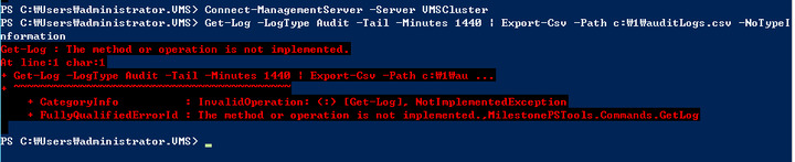

I entered,
Connect-ManagementServer -Server VMSCluster
Get-Log -LogType Audit -Tail -Minutes 1440 | Export-Csv -Path [c:\1\auditLogs.csv](file:c:/1/auditLogs.csv) -NoTypeInformation
and faced error message as below.
I really don’t know what to do next.
Please help me if you have any idea.
Thank you.

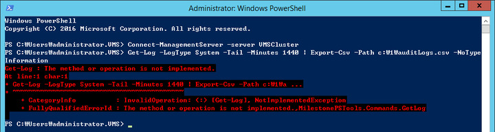

I also tried System LogType and it threw same error as below.

I’m thinking the issue is that the LogClient in 2020 R3 MIP SDK is unable to communicate with the Log Servers older than 2018 R3.
We implemented a new Log Server and made breaking changes requiring recompile to support the newer Log Server and I’m assuming the reverse is also true - the 2018 R3 and later SDK’s are unable to communicate with the old log server component.
Here are some release notes for 2018 R3 where this is mentioned
Restructuring MilestonePSTools to enable the user to select the SDK version they want to use is probably the only way to make Get-Log work in this situation and that is a fairly large undertaking that I am not prepared to do.
If it’s not feasible to upgrade to at least 2018 R3, I’m afraid the only option may be to write this yourself either in C# or PowerShell using the 2018 R1 MIP SDK binaries. Here’s how the Get-Log cmdlet is written in C# for reference:
