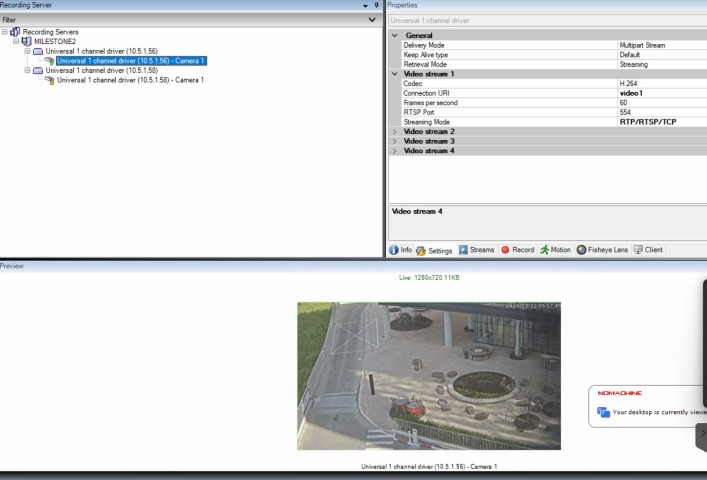

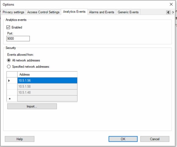

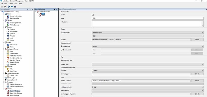

To provide further context and facilitate troubleshooting, I have attached screenshots of the XProtect application along with the relevant sections of my code.

Hi, could it be the sources have changed?
  • From the Management Client screen dumps it seems as the Source Name could be 10.5.1.56
  • The provided code is using 10.5.1.6,0
  • The provided sample uses 10.5.1.56,1
Please check that the actual Source Name matches the IP address of the source camera!
