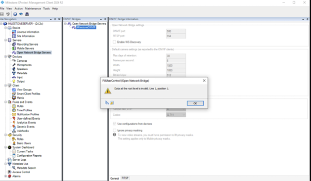

I added the ONB to the Management Client which also appeared to work as explained in the documentation. However, when I click on the ONB Server node that I just added, the following dialog box pops up indicating an error has occurred:

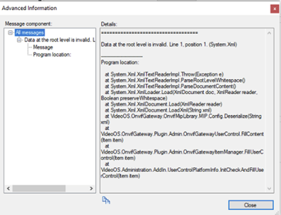

The details of the error are:

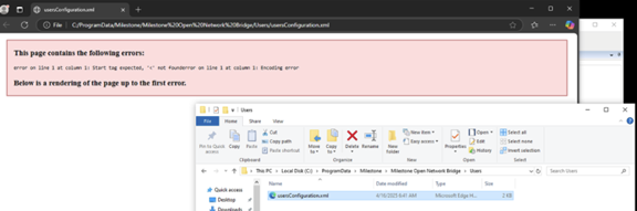

In ProgramData/Milestone/Milestone Open Network Bridge/Users there is a usersConfiguration.xml file that indicates an error in the XML format.

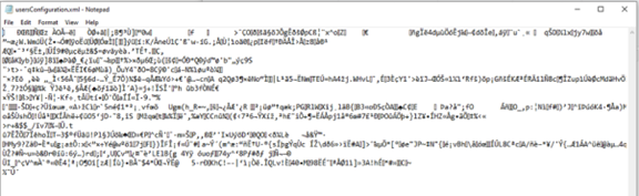

And if I edit it in Notepad I see:
Since the Dialog box title relates to Users (FillUserControl) I thought there was at least a remote possibility that this could be part of my problem.

  • [C:\ProgramData\Milestone\Milestone](file:C:/ProgramData/Milestone/Milestone) Open Network Bridge\Users​\usersConfiguration.xml shoud not contain readable xml. Content is encryptred.

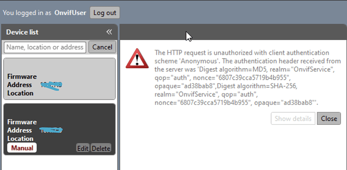

  • I installed ODM and confirmed that the ONB is NOT accessible from it. I get the following error:

Your error in ODM means that your user OnvifUser is misconfigured (or that you typed wrong password in ODM, which I doubt). Did you successfully add the user in VMS and then in ONB via tray controller?
Now, to go back to your original problem - error while loading the Management Client plugin: You may try the following:
  1. Open Management Client → Tools → Registered services
  2. Locate your ONB instance(s) and remove it/them.
  3. In Management Client → Open Network Bridge servers, right click your server and delete it.
  4. Uninstall your ONB (not the entire VMS) and install it again.
  5. Re-add it in Management client and hopefully the error won’t appear again.

That seems to have worked!
  • The problem with the user was that I had reinstalled the ONB and I forgot to re-add the user. So that took care of the ODM issue. I was still getting the error in the Management Client.
  • Deleting the ONB from registered services I think was the real issue. Once I deleted the ONB and then uninstalled and reinstalled it and then added it to the Open Network Bridge Server. It came up with a different server name (was MilestoneONVIF to milestoneserver) so my guess is that some of the settings for the ONVIF Bridge weren’t getting completely removed when I replaced it with the ONB.
The SmartClient Plugin that I wrote now seems to be able to access the Milestone VMS cameras.
Thanks again! I’ll do a little more testing but I think my issue is solved.
