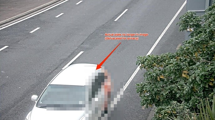

As above, the issue seems to be that issuing the GoTo to a specific timestamp, returns the nearest-available keyframe.

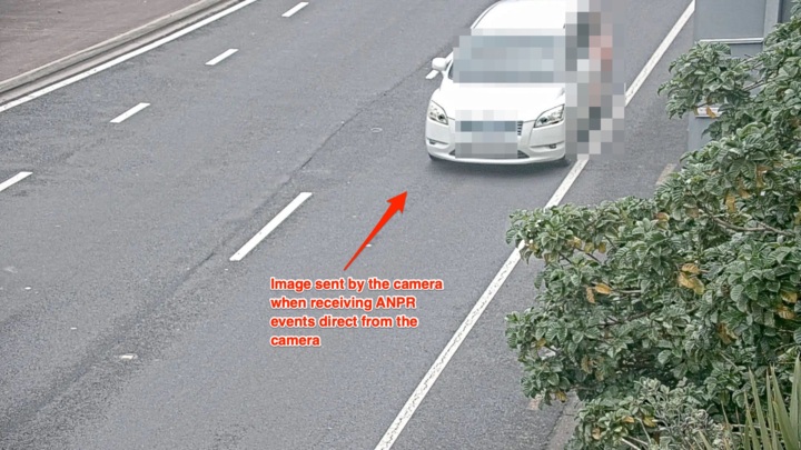

In the sample image attached, we request a timestamp at 1670361165319, however get an image from 1670361165717 - the second timestamp is what is returned in the ImageResponse header “current”. The plate on the car that generated the ANPR read has already exited the frame.
When looking at the image that the camera sends directly (Axis supports HTTP POST, which includes an image in each read), that is the actual frame that generated the read.
