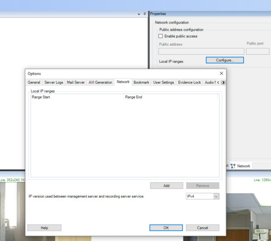

Hi. Can you check the video live and playback from Smart Client work with the Recording server from the remote machine? If they don’t work either, then you need to check the firewall settings, and also you can check the settings of the IP ranges in the Management Client → Recording Servers → → “Network” tab in the Properties panel → Network configuration. Check there are no special settings here, also under “Configure…” button, if you use the same local network.
There were some technical issues and the system has been down for the past couple of days. It’s back up now. However, it looks like something else changed because now the XProtect client can’t even access the server (see first image below). Originally it was just an issue with the Recorder. And I’ve triple checked it’s the correct IP address. It works when pointing at that IP from the host machine. Are there certain ports I need to make sure are open? Also, it doesn’t look like any settings are setup in the Network configuration (see second image below). Should there be?
Image is not available
I’ve confirmed video live and playback work from the Smart Client from the remote machine. However, I’m still getting the “Recording server is offline” message when running my application. I also turned off the firewall on the host machine just to see if that was an issue.
