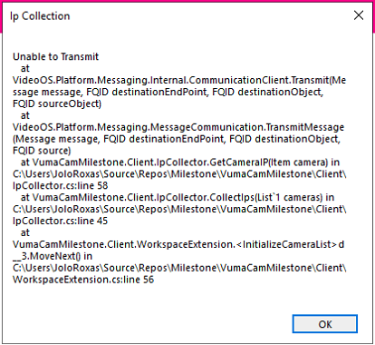

Just an update on the error (see img). Any idea?
My guess is that port 22331 and/or 22333 is blocked. That is why I linked to the knowledge base article, I hope it proves to be that because then it is not very difficult to fix.
