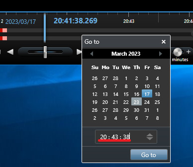

We are creating a process for displaying timestamps during playback operations.
I would like to be able to display timestamps like the Smart Client below.
​1.Playback the part without video
2.Go to specific time
3.Play from specific time
However, in my application it moves to the end of the SequenceDataSource after moving to the specified timestamp.

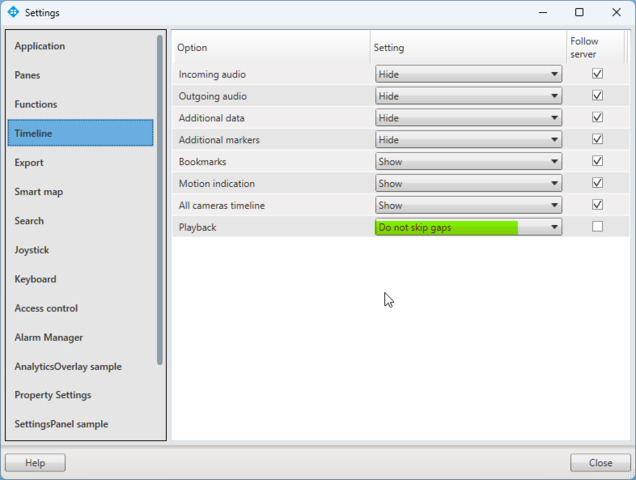

I think you are up against a configurable behavior in the Smart Client:
The default behavior is to “skip gaps”. In this mode the Smart Client will when playing back and finding no video skip to where there is the next section with recorded data.
In the Smart Client upper right find “Settings” (gear icon), find the Timeline tab, set the Playback to “Do not skip gaps” instead of “Skip gaps”.
