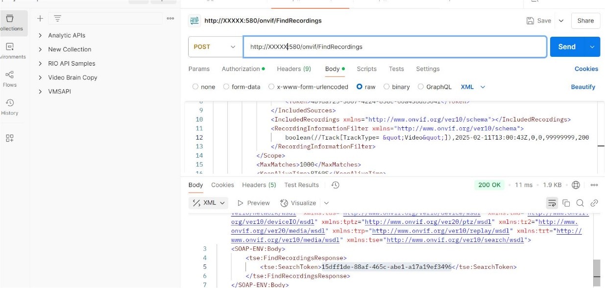

Based on the suggestion, we are able to use SOAP and execute the endpoint
http://xx.xx.xx.xx:580/onvif/FindRecordings with Digest authentication. We are getting http 200 response (refer to the screenshot below).

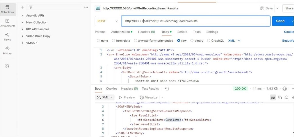

Based on the response, we are using search token in the endpoint
http://xx.xx.xx.xx:580/onvif/GetRecordingSearchResults but we are getting the result as “tt:SearchStateCompleted</tt:SearchState>” (refer to the screenshot below).

Hi Shibi,
It should be something with RecordingInformationFilter.
The format seems correct, as per the screenshot.
Try to play around with the parameters there.
I see you are using central time and interval after it.
Please make sure you are not using [UTC Now] or something. In other words central time should not be in the future. Bear in mind the central time is in UTC - you need to convert your local time to UTC first.
Also, you could try searching in the opposite direction - before the central time.
And ofc you have to ensure there are recordings for that camera. For example via SC.
We have seen there could be issues, if there is one and only single continues recording of the camera. Could this be your case ?

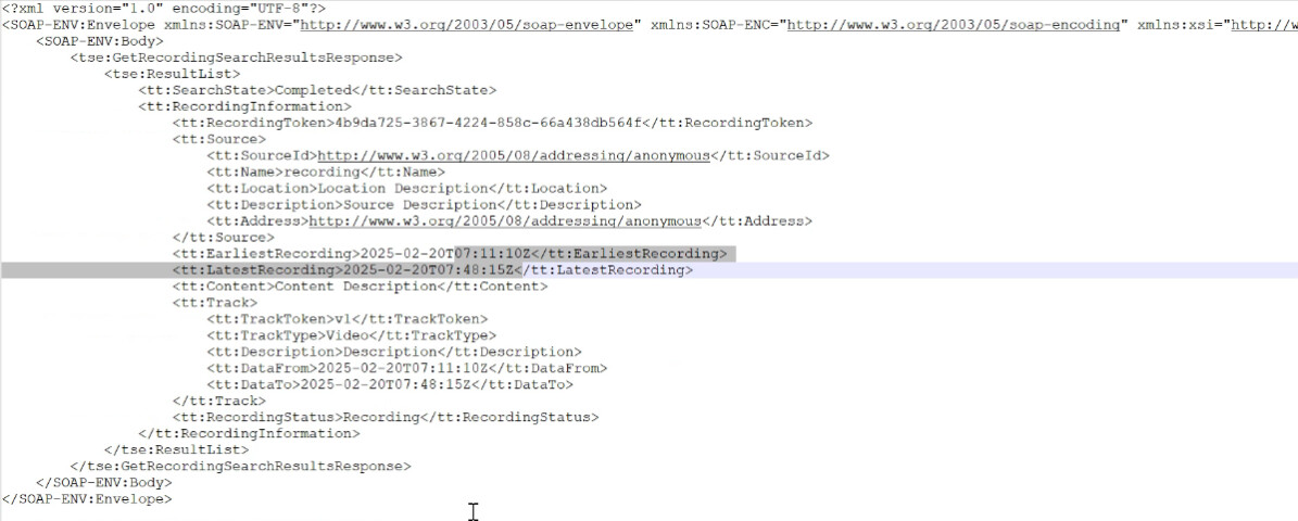

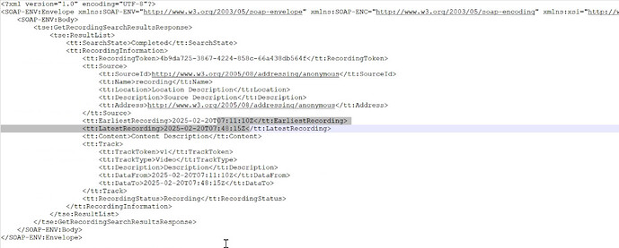

@Shibi Chacko
Thank you for your patience.
I did some debugging on the server side and it turned our parsing logic is not very robust.
You must always provide the RecordingInformationFilter value on the same line as its enclosing tag:
<RecordingInformationFilter xmlns="http://www.onvif.org/ver10/schema">boolean(//Track[TrackType = "Video"]),2025-02-19T10:48:48Z,99999999,20,99999999,20</RecordingInformationFilter>
In your example you provide it on a new line in the xml.
To avoid any doubt - you can find the exact content of my request/response xmls in the attached archive.
@Nikolay Dimitrov
Thank You, we got the Recording Information now, but can you please guide how can we get the RTSP url for that specific time
