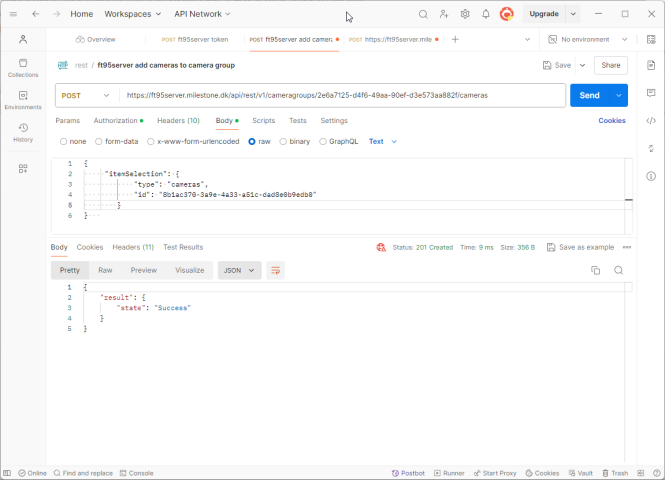

I must agree that the documentation is wrong. I will report this as a bug to Milestone Development.
When trying to figure it out using Postman I noticed the error that was given back:
    "error": {
        "httpCode": 400,
        "details": [
                "errorText": "Bad request: parameters missing",
                "errorTextId": "99999"
    "params": {
        "itemSelection": {
            "type": "cameras",
            "id": "00000000-0000-0000-0000-000000000000"
Then I did a new POST with new payload and success:
If you find other pieces of faulty documentation, please post here on the Developer Forum and I will report it so that the documentation can be improved. Thank you for reporting this one.
