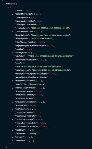

I am using the Milestone Restful API for my integration and the main issue is that i don’t get the full informations showcased within the documentation especially the cameras.
For instance it doesn’t contain the streams nor the settings among a lot informations, please refer to this image of what should i get according to the doc:
And here’s what i get (one camera) :

Yes those routes worked,
However, it was implied in the official rest documentation webpage that this was all going to be sent within /API/rest/v1/cameras/ alone, that’s why i thought it was over or maybe a problem from my heavy client.
So the main problem was indeed the implication of the documentation that was misleading…

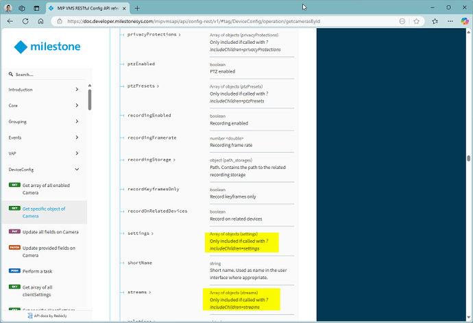

It turns out the documentation isn’t misleading, but I had a hard time finding the right information..
If you look at https://doc.developer.milestonesys.com/mipvmsapi/api/config-rest/v1/#tag/DeviceConfig/operation/getcamerasById
If you then expand the “200 OK” section you find -
-It actually describes a different approach to retrieving the information compared to my first answer.
owwwwww i didn’t notice this as i jumped directly to the result format…
My bad
