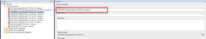

How do we retrieve hardware name instead of camera name listed under camera group?

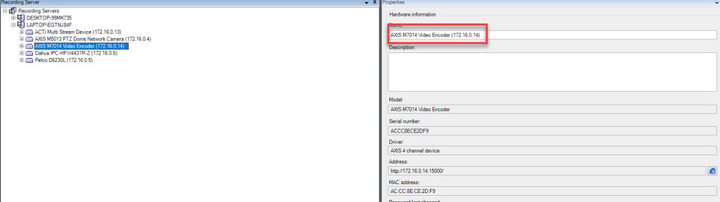

need below name
instead of
using List items = VideoOS.Platform.Configuration.Instance.GetItemsByKind(Kind.Camera);
provides list of cameras under camera group

If you used GetItemsByKind with “Kind.Camera”, then you get camera item which is not hardware. Instead, please test this code
VideoOS.Platform.Configuration.Instance.GetItemsByKind(Kind.Hardware, ItemHierarchy.SystemDefined)
NOTE: Please explore the Configuration Access sample -
https://doc.developer.milestonesys.com/html/index.html?base=samples/configaccess_sample.html&tree=tree_2.html
You will see differences between check-on and off the Physical Hierarchy checkbox in the dialog.
