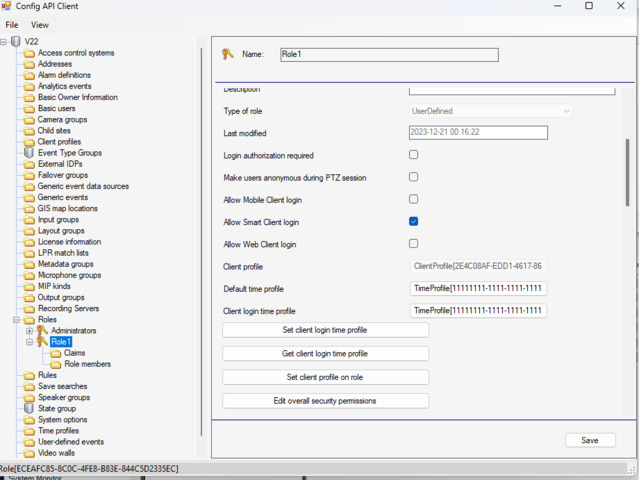

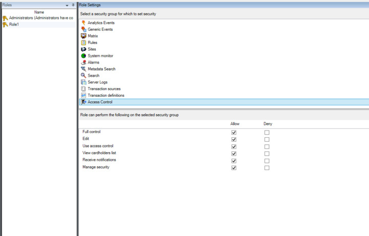

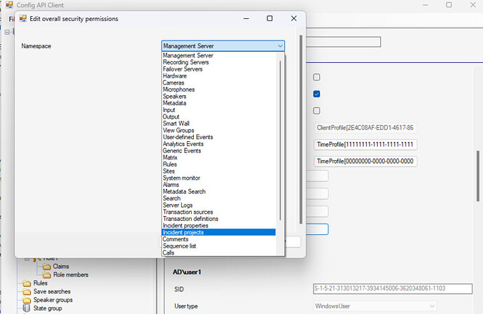

When we try to access Roles overall security
Missing AccessControl namespace to edit in configAPI

This is a known limitation. There is only very limited support for Access Control in the Configuration API (and RestAPI). It is on the wishlist for future enhancement development to lift the limitation but it has not been prioritized and there is no plan for developing this in the current plans.
