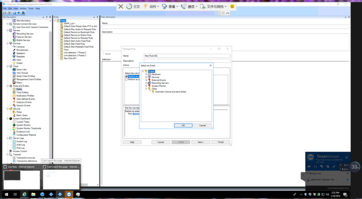

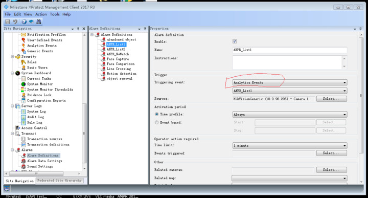

Hikvision are developing a plugin named ANPR plugin.In our test,we found a weird thing.
I have installed corporate 2018 R2 on 2 pcs,but when access “Rules and event->Rule->Add new->Perform an action on event”,there is “Analytics event” on one pc,but not on another PC.
Could you please tell me it there some steps i missed?How can “analytics event” display on all environments.
Please let me know if you need more details.Thank you in advance.
(Note:It’s about ANPR plugin,we can add an event on “Analytics event”,we want to linkage to perform further action(such as open door) after plate recognition.And it works well on just one pc,not all environment.)

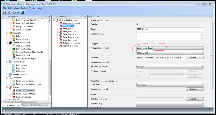

There is something fishy, you say that you have installed Corporate 2018R2, yet the screen shot shows a 2017R3 Management Client! Please verify product and version..

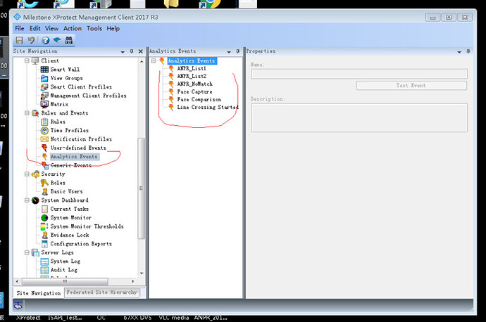

If you pick the Rules and Event - Analytics Event tab in the left hand side do you have the expected analytic event(s)?

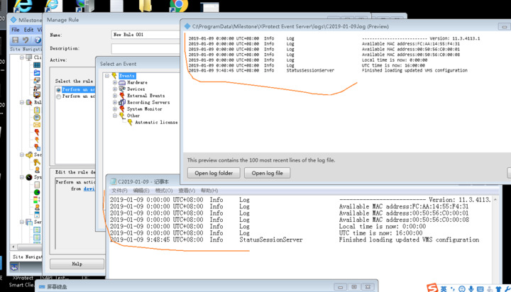

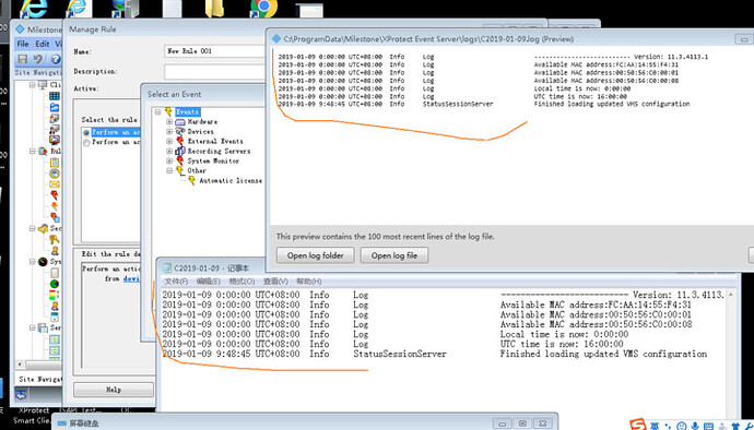

If you examine logs, primarily for the Event Server, do you see any error that might be causing this?

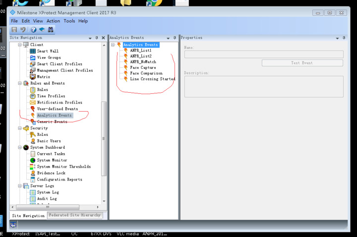

Thank you for your reply.(Sorry for not providing screenshots of 2018 R2 corporate version.)
2017 R3 corporate also can’t show analytics event.The attached screenshots can show what you requested.

The attached screenshot is 2018 R2 corporate.
So,in your opinion,does analytic event exist on “rules and event” of all Milestone software?
Now after we develop ANPR plugin.We can use the rule only on some environment.
