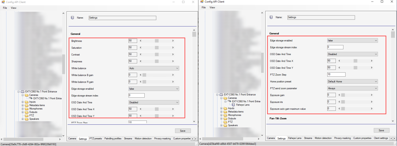

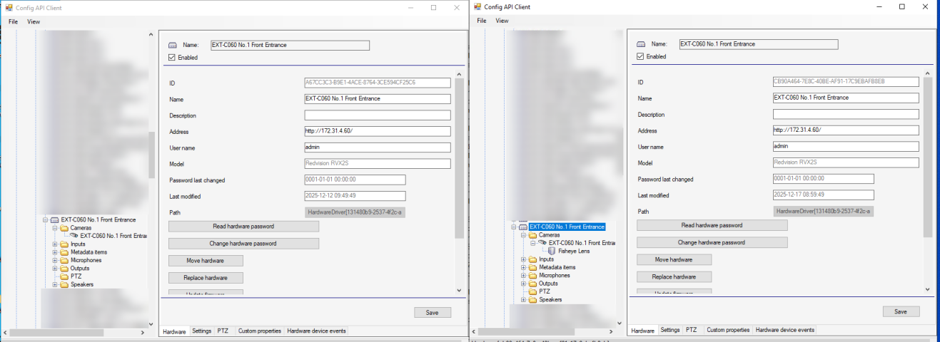

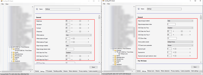

We have added the same camera to two recording servers, and when we check the camera settings, both show different lists of settings, even though the driver and firmware versions are the same. Images of the same are attached.

In the first 2 images there is a difference, the camera on the right has a “Fisheye Lens” item that the other does not have.
Frediano
You are right, we observed that too. But it is the same camera that is added to different recording servers. How can the settings change?
