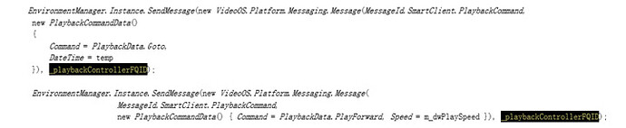

The following MIP SDK interface works in 2020R3 MIP SDK, can play video normally but do not work in 2021 R1 MIP SDK,shows ‘after recording’. We find it works in 2021 R1 after change ‘playbackControllerFQID’ to ‘null’, but 2020R3 do not work in this way. Something has changed in these two version.Any advice?

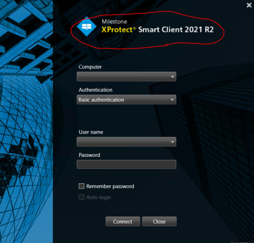

Which version of Smart Client are you using for now? When you start Smart Client, you can see SC version in the login dialog, see this example -
hi, both failed for 2021 R1 and 2021 R2
We tested your code on SCIndependentPlayback sample and it works fine. Let me show you what we did.
Add following code (this is actually your code) into SCIndependentPlayback2ViewItemUserControl.cs
private void button1_Click(object sender, EventArgs e)
DateTime temp = DateTime.Now;
EnvironmentManager.Instance.SendMessage(new VideoOS.Platform.Messaging.Message(
MessageId.SmartClient.PlaybackCommand,
new PlaybackCommandData()
Command = PlaybackData.Goto,
DateTime = temp
}), _playbackFQID
double m_dwPlaySpeed = 1.0;
Command = PlaybackData.PlayForward,
Speed = m_dwPlaySpeed
}), _playbackFQID
Deploy SCIndependentPlayback.dll and run Smart Client with SCIndependentPlayback sample.
Please test it and see if it works for you.
