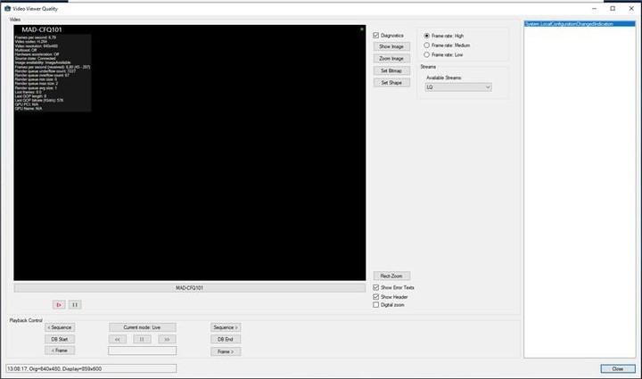

During a migration from SDK2017R3 to SDK2020R3 we noticed that whenever our imageViewerControl is resized above the actual size of the displayed stream, the stream is not rendered anymore (black screen, but diagnostics infos can still be displayed and show everything is “normal”).
Restoring the imageViewerControl to a size smaller than the displayed stream, brings back the video stream rendering.
This can very easily reproduced with any 2020R3 SDK samples (ie: VideoQualityViewer or other sample dynamically adjusting the viewer size).
Just choose to display a low res stream and stretch the sample video above stream resolution.

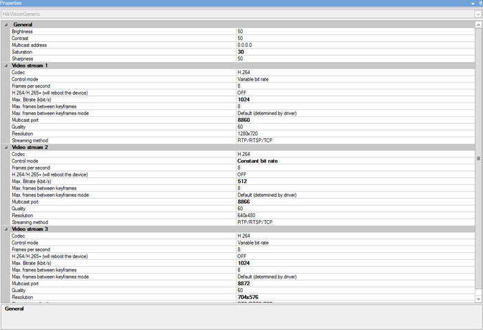

We have tried to reproduce the issue but no success. Can you please add screen captures about your camera settings and camera streams on Management Client?
Here is a screenshot from the camera configuration.
There are 3 streams but we are using stream 1 and stream 2 only with this camera.
The described issue can be reproduced with both streams 1 and 2 whenever the rendering surface from imageViewerControl gets larger than stream native resolution.
