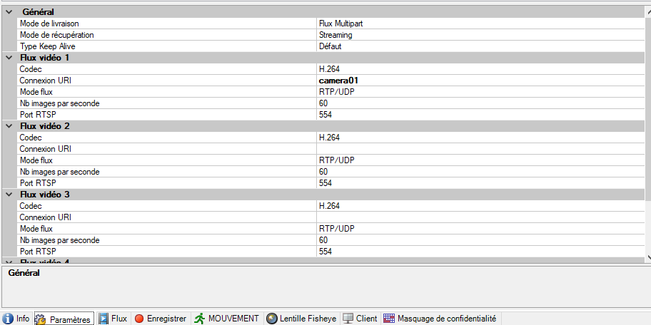

However, for some manually edited (on XProtect Admin) cameras, GetItem throw an not found exception whereas I have some stream and infos:
How do I access to the codec of thoses cameras and programatically edit it ?
Your code works for me.
I tested with the Universal Driver because the image you posted looks like it is using this.
Can you elaborate on what error you see exactly? Please include if there is a special camera / camera driver that is involved. Some cameras might work and others fail, if you can include your observations on this it might be a valuable clue.

I tried your code. I can indeed get the info without errors that way, but setting the property codec does not change the codec in admin…
                StreamChildItem streamChildItem = streamChildItems.FirstOrDefault(x => x.DisplayName.Contains("1"));
                var previous = streamChildItem.GetProperty("Codec");
                streamChildItem.SetProperty("Codec", codec);
                logger.Debug($"codec changed from <{previous}> to <{streamChildItem.GetProperty("Codec")}>"); //<-- log received : codec changed from <h264> to <mpeg>
after running program I checked in Admin:

I tried this code and got an error :
VideoOS.Platform.Proxy.ConfigApi.ValidateResultException: Une exception de type ‘VideoOS.Platform.Proxy.ConfigApi.ValidateResultException’ a été levée.
edit 1: I think it doesn’t recognise “mpeg”… it may be a false alarm
edit 2: Okay it works, thank you.
