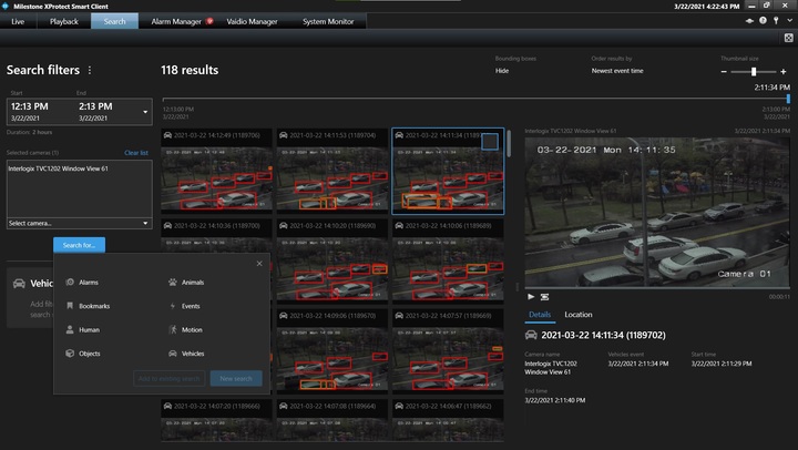

We developed a video analytic search base on the “Search Agent” Plugin sample.
https://doc.developer.milestonesys.com/html/gettingstarted/intro_searchagent.html#_Sample_search_agent
Below is our screen-shoot. It works for XPCO and XPE as identified in the document as the catalog added, Vehicles, Animals, Human, and Objects are there. But XPP+ does not. Many of our approaching customers request for video analytic base on existing XPP+ deployment, is this limitation can be flexible in code or some suggestion we can do for our customer who is asking for a video search plugin for XPP+? Many Thanks.

To my knowledge there is no workaround with limited implementation suited for the lower versions of XProtect..
thank you, understand that there is nothing we can do other than license upgrade.
