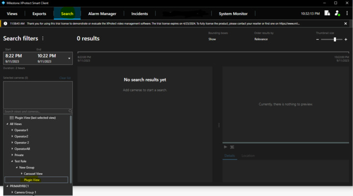

Search tab/Evidence lock, selecting view with a plugin, shows no camera.
Hi,

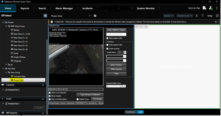

Have created a view with sample plugins placed inside(ServerCarrousal, VideoPreview).
When changing the tab to Search and selecting the plugin view, we can’t see the camera; we have set EmbeddedClient property. Shows only views with native camera item.

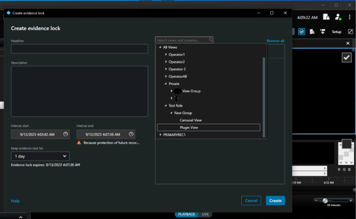

Same with evidence lock
