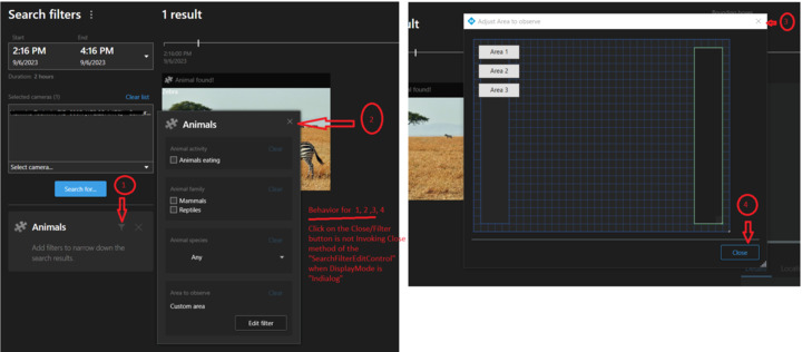

I am developing a search agent plugin that contains two custom controls, one with DisplayMode SnapToParentWidth and another InDialog,
When selecting a search category, the “CreateSearchFilterEditControl” method will create a new object for each custom “SearchFilterEditControl” control.
When the filter category is selected and the popup window is closed,
SearchFilterEditControl → Close() method is not invoked for controls having "DisplayMode " set toInDoalog, and for controls having "DisplayMode " set to SnapToParentWidth, the Close() method is invoked every time.
This is causing an increase in memory when a Search Filter popup window gets opened that is calling the “CreateSearchFilterEditControl” method to create a new object.
I have tried with the sample provided in “mipsdk-samples-plugin” → “SCSearchAgent” it is also behaving the same.
Code chunk from “mipsdk-samples-plugin” → “SCSearchAgent” Sample
Close Method is not Invoked

@Parth Modh​ Thank you very much for reporting this. I can reproduce the issue you’re describing, and can confirm that it is a bug.
Your assumption about Close() being called is correct, and this does not currently happen for edit controls displayed in their own dialog.
We will aim for having a fix included in the next release.
