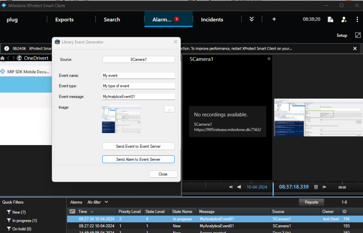

I haven’t gone through your code.
But I have an idea that this might help.. There is a “flaw” in the LibraryEventGenerator sample, it does not include the snapshot image when sending an alarm only when sending an analytics event.
Please make this modification.. (EventForm.cs line 145)
// added section starts
SnapshotList snapshots = new SnapshotList();
for (int ix = 0; ix < _imageList.Count; ix++)
	snapshots.Add(new Snapshot()
		Image = convertImage(_imageList[ix])
//added section stops
Alarm alarm = new Alarm()
	EventHeader = eventHeader,
	StateName = "In progress",
	State = 4,
	AssignedTo = "test (\\test)",
	SnapshotList = snapshots //added
With this modification, the Smart Client displays the snapshot image like this..
https://doc.developer.milestonesys.com/html/index.html?base=samples/componentsamples/libraryeventgenerator/readme.html&tree=tree_2.html
I hope the modified sample works for you and you will be able to detect how your code might be different.
