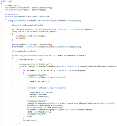

I’m working on a plugin which has a thread running in the background of the plugin, this thread is an httplistener server which listens to a specific address and waits to receive data, when httplistener sees data it analizes it and if it’s “OK” the data will be used to send a message to the alarm list of Smart Client.
I do something like this:
A list of analitic events is created during initialization, we use a json file to programmatically generate this analitic event. We use the information from these analitic events to compare with the data frame received and sent the alarm, but it doesn’t work.
Do you have any idea what is missing for it to work?

                        EventSource eventSource = new EventSource()
                            Name = "192.168.168.39"
                        EventHeader eventHeader = new EventHeader()
                            Timestamp = DateTime.Now,
                            Message = "[" + IHMEventConf.Level + "] " + IHMEventConf.ID +" "+ IHMEventConf.Description,
                            Source = eventSource,
                        VideoOS.Platform.Data.AnalyticsEvent analyticsEvent = new VideoOS.Platform.Data.AnalyticsEvent();
                        analyticsEvent.EventHeader = eventHeader;
                        EnvironmentManager.Instance.SendMessage(
                    new VideoOS.Platform.Messaging.Message(MessageId.Server.NewAlarmCommand) { Data = analyticsEvent });
                                Message = "[" + IHMEventConf.Level + "] " + IHMEventConf.ID + " " + IHMEventConf.Description,
