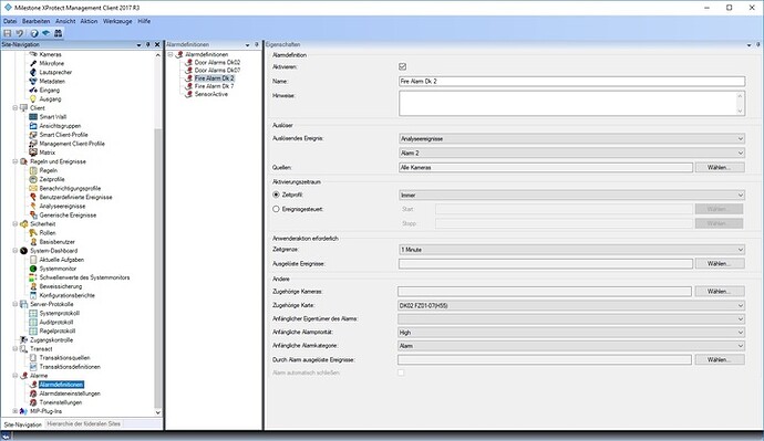

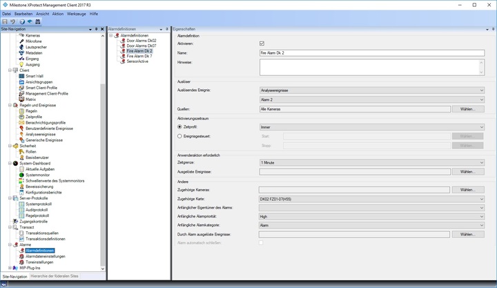

Ok, I try to do that. But we use an analytics event and I’m not able to create this rule with an analytics event. I use “Alarmdefinition” in “Alarms”, see picture..
Maybe something there is wrong.

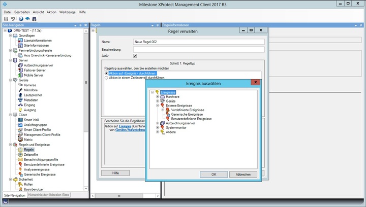

So in rules the Analytics Events are missing?
SelectAnEvent
The known issue I mentioned fits except that issue is solved in, but the is solved in version (11.3a) 2017R3
Right, I don’t have Analytics Events in this window.
