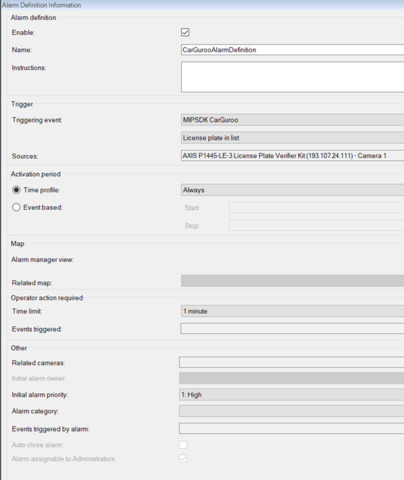

  • Enable events in Management Client options (off by default)
  • Add Alarm Definition in the Management Client, after creating an event group and event type, code example:

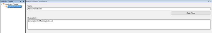

  • Then I create Create Analytic Event in the Management Client
  • When activating our camera item (for test example), I try to send events and alarms. Examples (various options):

  • The res variables at the end of each method contain an empty collection.
  • As a result, the Smart Client Alarms Manager is empty. But if you click on the Test Event button in the Management Client (see point 3), then this test event appears in the Smart Client.
