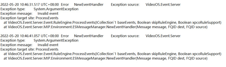

Sending analytics events through the event service plugin keeps failing

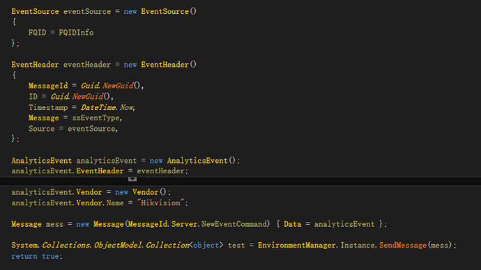

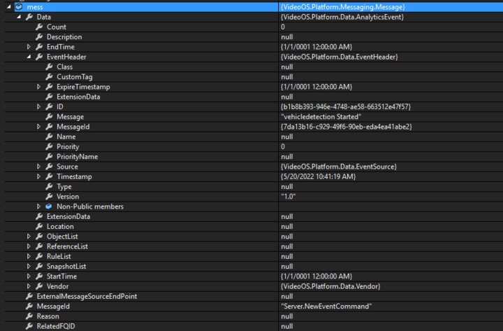

Sending analysis events through the event service plug-in has been failing, and the MIP log shows ArgumentException. The content of the Message message is as shown in the figure. I want to know which parameter is wrong and will cause the ArgumentException. In addition, there is no such problem when the same code sends the same Message in the Standalone Service before.
In order to verify if an unmodified sample work, can you please try to test with an unmodified sample called Analytics Event Trigger via library?
https://doc.developer.milestonesys.com/html/index.html?base=samples/componentsamples/analyticseventtriggervialibrary/readme.html&tree=tree_2.html
Also, I noticed that you wrote it was working “before”, do you remember if you changed anything on the machine? If you added some changes, what did you do?
