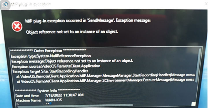

Hi,
With my plug-in, when sending a message StartRecordingCommand for a selected camera item in Admin Client , the SC throws up an error message.
Using SDK 2022 R1
var playbackWorkspace = ClientControl.Instance.GetWorkSpaceItems()
            .FirstOrDefault(item => item.Name.Equals(EWorkspaceType.Live.ToString()));
            if (playbackWorkspace != null)
                                    EnvironmentManager.Instance.SendMessage(
                    new Message(MessageId.Control.StartRecordingCommand,
                    playbackWorkspace.FQID), playbackWorkspace.FQID);
Thank you in advance for your help
Firstly, please do not use the phone picture for showing the error message. Please send us error messages as text, you can add a picture and in that case please take a screen capture.
Can you please check if playbackWorkspace or playbackWorkspace.FQID is null? Also, is this playbackWorkspace valid camera item?
Please debug the plugin and see if it is valid -
https://developer.milestonesys.com/s/article/debugging-techniques-for-Smart-Client-plugins
Please test if unmodified Message Tester sample works for you -
https://doc.developer.milestonesys.com/html/index.html?base=samples/pluginsamples/messagetester/readme.html&tree=tree_1.html
if the sample works you could reuse source code from that sample.

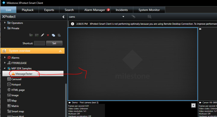

Hi Rie,
Unfortunately I don’t see the part of Message Tester in gui.The MessageTester.dll is stored in %PROGRAMFILES%\Milestone\MIPPlugins\MessageTester folder.
MessageTester sources are taken from
https://github.com/milestonesys/mipsdk-samples-plugin
Maybe the problem is that MessageTester is released for XProtect 2022 R2, and we are working with XProtect 2022 R1 release?
Thank you
I can see Message Tester in your image in the previous reply. Your settings are correct.
What you need to do is –
Start Smart Client – go to Setup mode – select “MessageTester” under MIP SDK Sample – drag and drop it on a view – escape from Setup mode.
