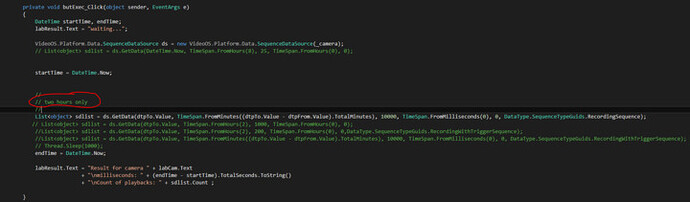

If I understand correctly you have modified the code, the GetData is different now I guess, for clarity could you please show you new code (snippet showing the parameters and call)?

Test code:
