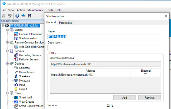

  2. Start Management Client - go to left pane on the top, you will see server name – right click and select Properties. Please check if URLs is correct.

Please make sure that if there are differences between actual installation and settings, the sample would not work.
