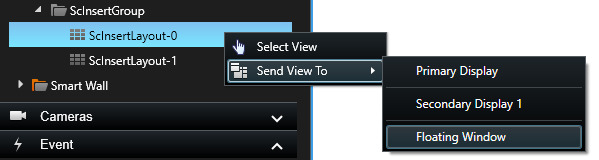

This is by design, so you cannot use same view for multiple windows. If you want to use multiple windows, you will be able to use different views as a workaround. Let me explain about it using SCInsertCamera sample.
1.Start Smart Client.
2.Create 2 views with SCInsertCamera, click Create 1,5,1 layout.
SCInsert1
3.Send SCInsertLayout-0 to Floating window.
4.On main window, you select SCInsertLayout-1. You can see SCInsertLayout-0 on Main window and SCInsertLayout-1 on Floating Window.
5.Select a camera and set Index, then insert the camera to the index.
