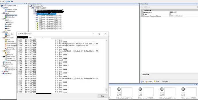

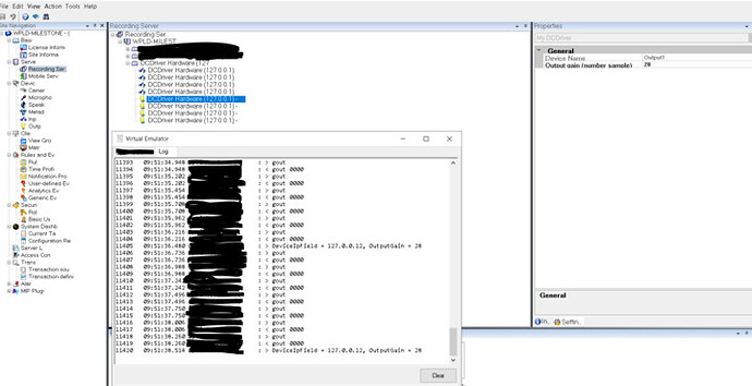

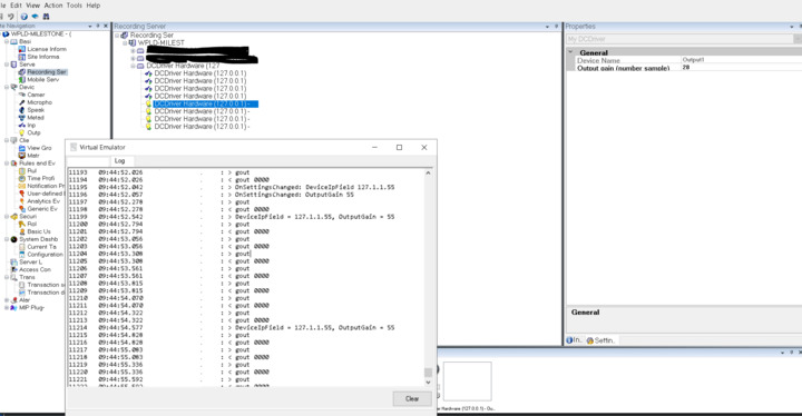

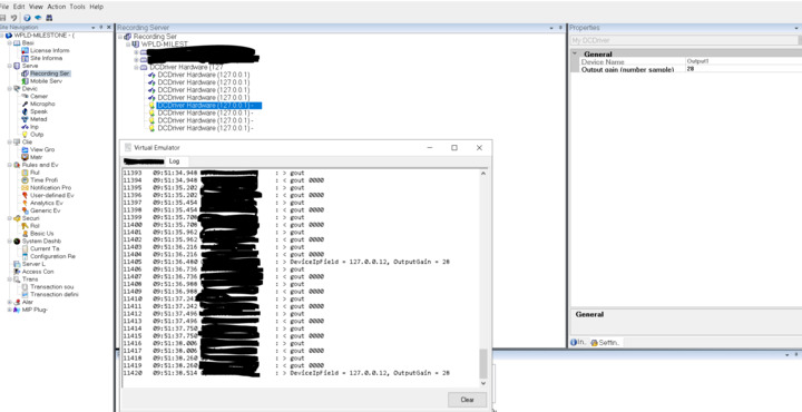

Attached are couple of captures from my log, I am using one Hardware setting and one Device setting (these are dummy settings, so ignore names :slight_smile: ).
You can see OnSettinsChanged is raised and the new values are valid, but UI doesn’t change even if I do refresh (see CaptureHardwareUpdateSettings.png, CaptureDeviceUpdSettings.png).
If I restart my device (emulator in this case), the connection is restarted and the old values became valid (see CaptureAfterReconnect).
