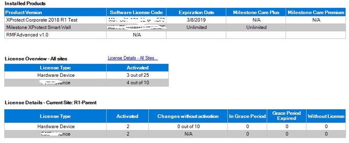

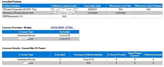

Hi @Bo Ellegård Andersen (Milestone Systems)​
We have used _myServerLicense.CounterMethod = LicenseInformation.CounterMethodEnum.CountByCounter;
We have set counter to 10 in licensing website.
As you can see in current site , we have activated counter = 2, but license overview show as 4 out of 10
@Bo Ellegård Andersen (Milestone Systems)​ are we doing something wrong, why the difference in Allsites and current site?
