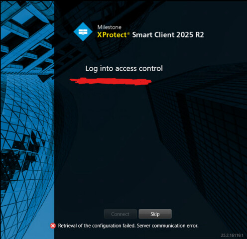

Our access control integration breaks with XProtect 2025 R3. When starting Smart Client there is an error:

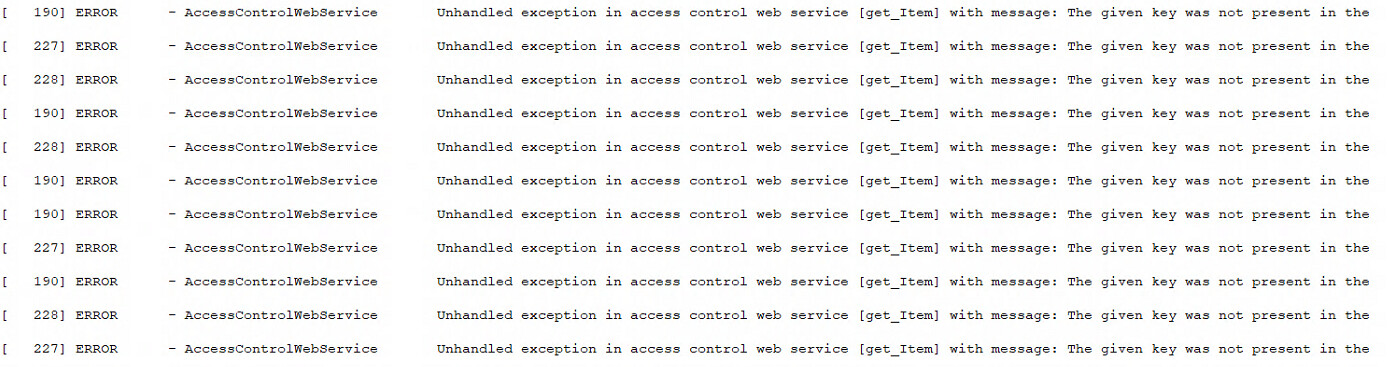

We can see errors in the XProtect logs:
We don’t see any errors in our logs.
Is this a known issue?
What can we do to troubleshoot, not much information to go on here?
Thanks!

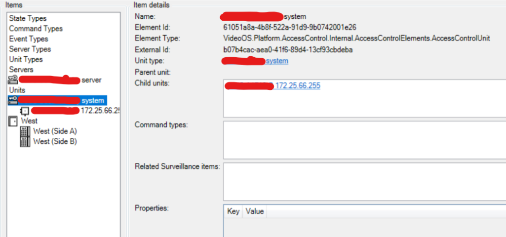

Attaching the ACUnit configuration from one of the test systems that have this problem (“DEV: Info” tab). We do define a “system”. Anything that looks wrong?
Hello,
Everything seems to be as it should, other than it’s not necessary to define both a Server and a ACUnit to represent an AC system.
The only thing that I think you can try is to remove and add the system again. I also wanted to ask if you tried using an R3 Smart Client and if that was working.
