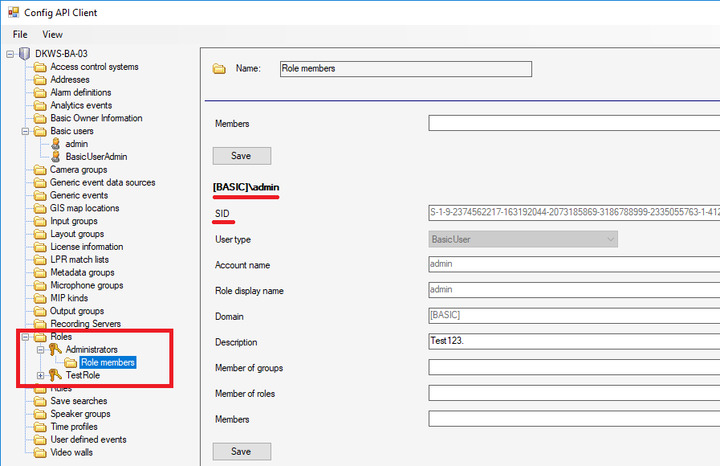

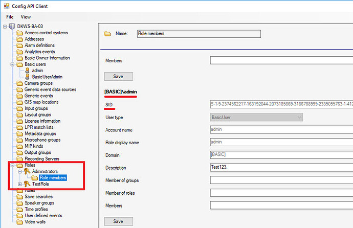

Please see Config API Client sample which shows you user information, please see below picture -
https://doc.developer.milestonesys.com/html/index.html?base=samples/configapiclient.html&tree=tree_2.html
So this value is the SID of each User.
In a plugin integration mode, how can I get this SID in the server ?
Thanks
It is possible to use the Configuration API and use the same code in Plugin Integration.
