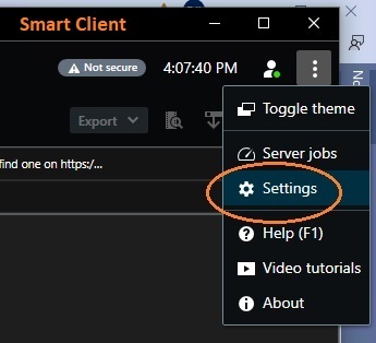

  • I used the Milestone sample “AnalyticsOverlay”, but: How do I reference these values in the rest of my plugin?
  • My plugin seems to not load these until the user clicks on the circled Setting option.
  • What is used to reference them?
