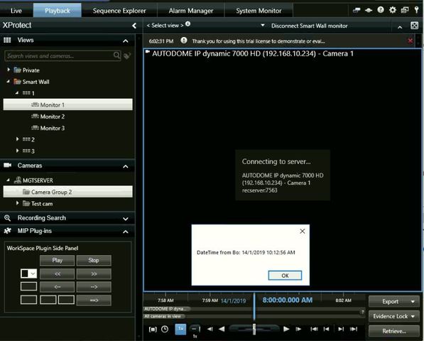

Thanks for the reply.
I tried with “SmartClient.GetCurrentPlaybackTimeRequest” as shown in the code snippets below, adapted from
private void OnResize(object sender, EventArgs e){…}
function from
\PluginSamples\SCBookmark\Client\BookmarkSampleSidePanelUserControl.cs
but the result (shown in image attached) is correct with the date but not the HH:mm:ss time.
        private void GetCursorTime()
            FQID FQID_PlaybackController = ClientControl.Instance.GeneratePlaybackController();
            Collection<object> result;
            result = EnvironmentManager.Instance.SendMessage(
                new Message(MessageId.SmartClient.GetCurrentPlaybackTimeRequest),
                FQID_PlaybackController);
            if (result != null && result[0] is DateTime)
                System.Windows.Forms.MessageBox.Show("DateTime from Bo: " + (DateTime)result[0]);
You are now generating a new playback controller and not getting the one default used by the Smart Client (no use of GetPlaybackController).
I ran a test, and I would like to recommend that you can simply leave the PlaybackController out (and get the default)..
This works for me in my testing..
result = EnvironmentManager.Instance.SendMessage(new Message(MessageId.SmartClient.GetCurrentPlaybackTimeRequest));
    DateTime show = DateTime.UtcNow;
    show = (DateTime)result[0];
    show = show.ToLocalTime();
    System.Windows.Forms.MessageBox.Show("DateTime from Bo: " + show);
Note that you will get the time in UTC, which explains the conversion in my code..
Thanks! It’s working.
