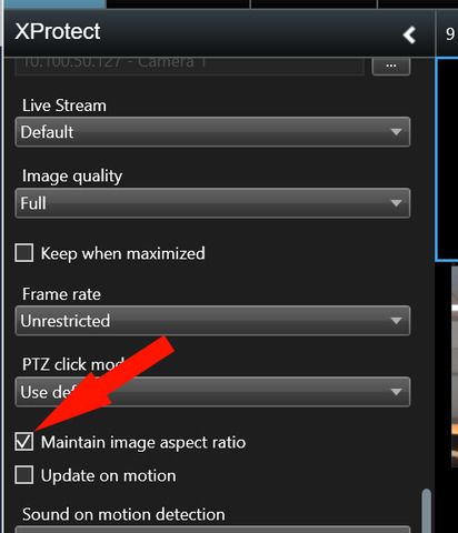

If it is in all of Smart Client, you can simply edit the view items in Setup mode and untick the “Maintain image aspect ratio” for all your cameras; see the picture below.
It’s for the SmartWall and the option is not displayed.
