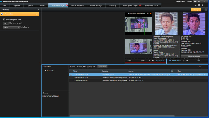

I have a plugin integration that generates Analytic Events in Alarm Manager tab.
Due a final client need, I´m developing a solution to generate Milestone Alarms too.
My issue is that I can see snapshot images with certain information of our software if I use Analytic Events.
There are the images inserted in the left panel.
But when I try to do the same with alarms, I can not see it (note that I´m able to generate alarms properly in the system)
alarmPreview2The images in the grid are from the part of the UI that is “editable” from code. But we need to show the same images that in the first image, but using Alarms instead of Analytic Events.

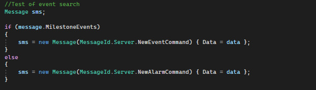

From the code side (I´m using you SDK, in c#), I populate both structures in a similar way:
Where snapshotList contains the same type of images for both elements .
when I send the message, I do it in a similar way too:
Is this possible in Alarms? I understand that if we have the same field SnapshotList in both kinf of notifications I´m able to see the same information in Alarm Manager tab.

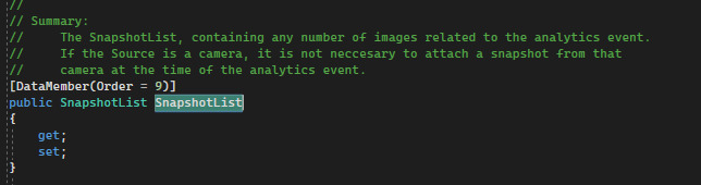

So the image format was correct, the process of the Alarm too, but it seem that FQID value “blocks” the images sended through SnapShotList field, but only in Alarms, not in Analytic Events.
That is curious, because I can see this information about the SnapShotList field
Anyway, this was the problem, and now it works.
