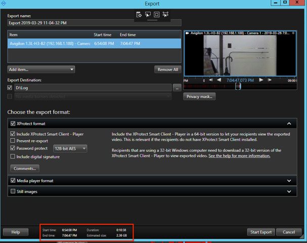

Dear Andersen,
We found that there have an Estimated Size indicator before export file in MIlestone 2019R1.
Please advance that how should we do that with SDK, thx.

This is your interface to tell the Smart Client what your data size is, it only says something about your plugin and the data your plugin introduces.
The functionality on the Smart Client Export dialog is unfortunately not exposed so that it can be used in a MIP plugin. There is no functionality to estimate what size an export will be.
