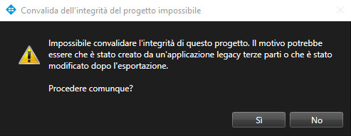

Bob, I compiled the application with the 2020R2 SDK and tried it both on 2020R3, and on 2021R1 and everything works fine, including queuing in the same folder.
Unfortunately the Player, which does not find the tampering key, at startup it gives the previous message and then it starts up normally.
The problem is that most of the End Customers are law enforcement agencies and they interpret the message as if they were providing altered videos.

If you export in Milestone format from a version 2020R3 or newer (Smart Client or MIP SDK) the export will include a SCP file with information that allows it to be verified that it has not been changed after the export, this is the new anti-tampering precaution.
If you export in Milestone format from a version 2020R2 (Smart Client or MIP SDK) the export will include a SCP file without this information.
If you use the older export playing it back using a new (2020R3 or newer) Smart Client Player, you will get the warning.
If you want to use the newer Smart Client Player, you should use the newer Smart Client or MIP SDK to create the export.
In general Milestone does recommend to use the newest MIP SDK. (Currently this is MIP SDK 2021R1.)
