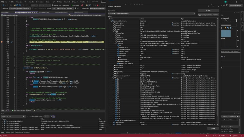

I have a hunch that I might need more info on the Common.PluginItem; is it a regular item with a Properties collection or is it something else? Perhaps you can outline how the Item, and its FQID, looks like.
This is PluginItem:
Frediano
