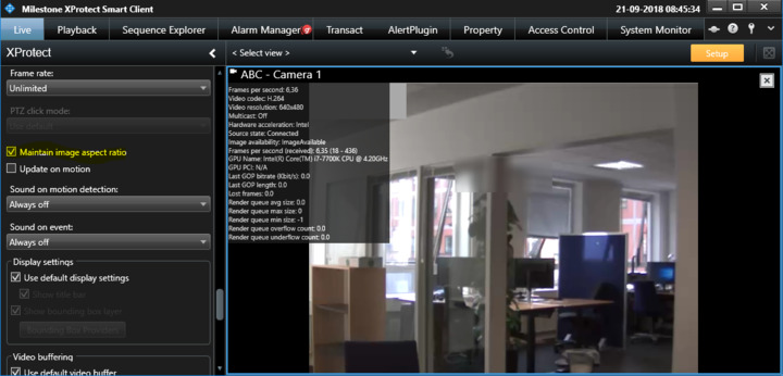

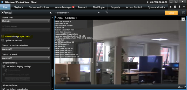

When creating a layout and triggering a multiview command, is it possible to set the cameras to stretch to the size of the view items? I know there is an option in the smart client to do this for individual view items e.g. stretch a 4:3 image to accommodate a 16:9 layout. Client is frustrasted with the black bars on either side…
I do not think this has to do with the development you made, but with setup in the Smart Client. You can for any camera view item go into setup choose whether to use “Maintain image aspect ratio” or not.

You will have to create your views or modify your views to use the not use “maintain image aspect ratio”.
The use of “maintain image aspect ratio” is default and this default cannot be changed, not through setup or MIP SDK.
The Smart Wall will use “maintain image aspect ratio” and this cannot be changed.
When you modify an existing view in setup note that there is an “Apply to all” button so that you can in one click share the setting with the rest of the camera view items in the view.
