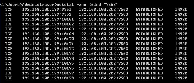

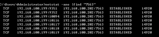

We noticed the tcp connections increased abnormal. here is the pic.
In live mode(7connections, 2*2 views, 4 video streams from 2 cameras):
switch to playback mode(15 connections):

It’s a standalone application. We tried to run PlaybackWpfUser sample and didn’t find the problem. When swith mode between live and playback, there is no additional connections. Only when we choose different camera, the original connection were destroied and new connection were set up. We’re trying to reproduce with simple code. At that same time, if you can help to explain the mechanism of mode switch in ImageViewerWpfControl, that would be great. E.g, the number of tcp connections should change or not when switching mode.
