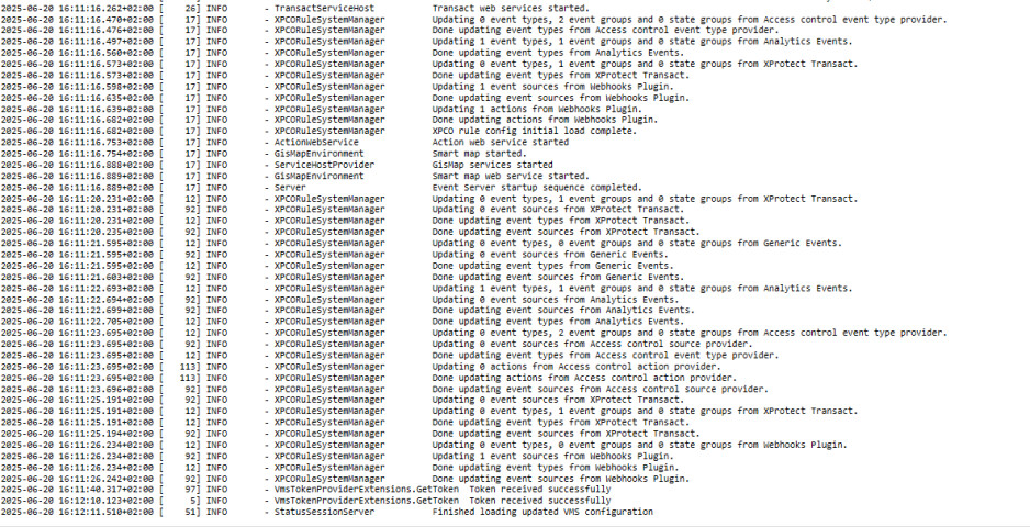

What could be the reason that the Event Server does not pick up my plugin and register the event type and groups? How can I debug this?

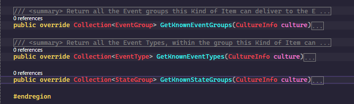

I have set up the GetKnownEventGroups, GetKnownEventTypes, and GetKnownStateGroups functions.
