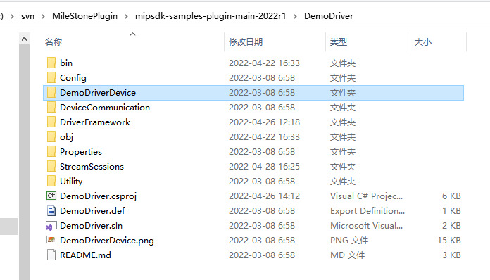

In additon,can I get the source code of DemoDriverDevice to have more tests?
DemoDriverDevice is using screen grabbing and that operation is known for high CPU usage. It means that the actual FPS of the device depends on how much CPU is available on the machine where it is running, and the higher FPS is set, the more CPU is needed. If there is not enough CPU available, the actual FPS will differ from the value set in the camera settings.
