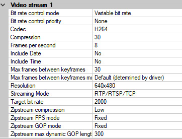

Can you please tell me the GOP size (camera setup) that you using for now? (A screen capture of a typical cameras properties -settings tab- from the Management Client is a good way to show us.)
Seems the Smart Client saves snapshots at the correct time on live.
settings from management server:
