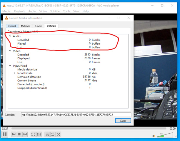

The ONVIF client and VLC player was no soundtrack on the camera streamming through milestone open network bridge (ver. 20.3a)
My network camera was AXIS P1365 MK-II, and when I use VLC direct connect camera streamming over RTSP, that had the audio, but when I through milestone open network bridge that had no soundtrack , I check my camera profile that use ONVIF-S, and use ONVIF device manager also had the audio. so may i know which camera’s UUID on the milestone open network bridge had the soundtrack?
Milestone Open Network Bridge supports only video, no audio.
